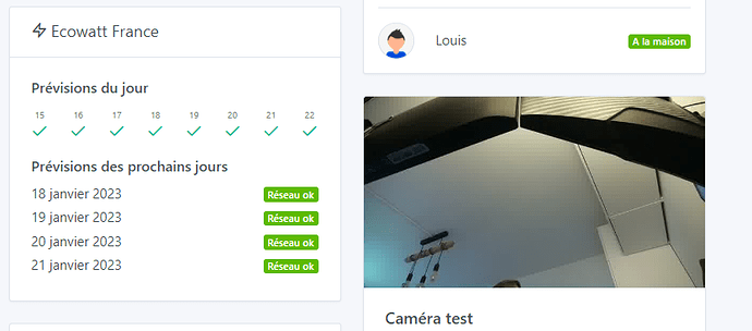

My camera is visible :

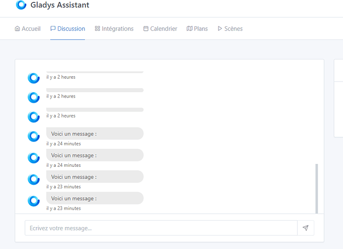

But when in a scene I ask to retrieve and send the latest image, I get nothing :

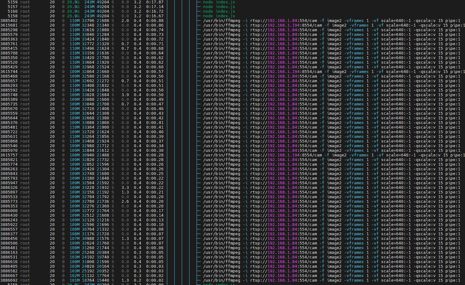

After some research, I confirm two things :
  1. It’s probably a bug
  2. There’s an error with ffmpeg

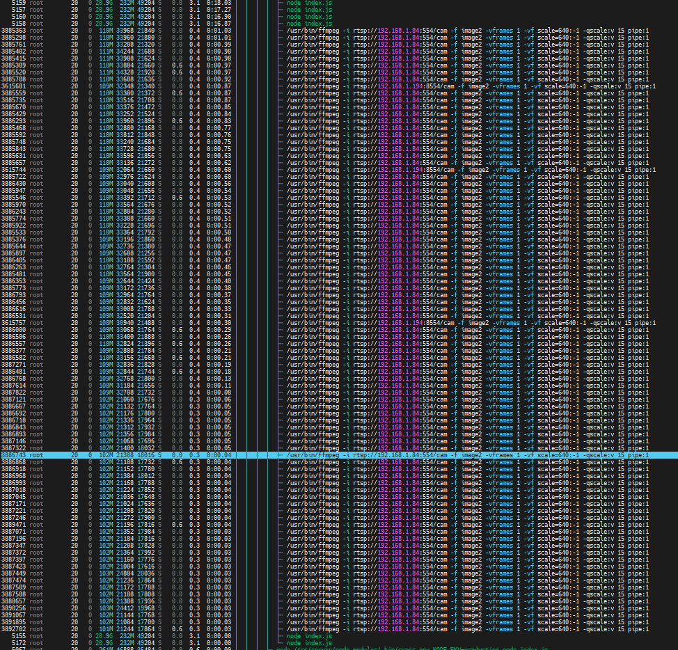

Update every 2 seconds, after a few minutes:
Same, one minute later:
Same one minute later:

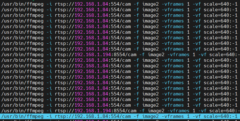

You can see a lot of new ffmpeg threads, never closed (should there be a 2-second timeout otherwise?).
Finally, I changed the port used for RTSP on my camera (#DIY) and I still see threads using the old port. Proof they were not stopped in time.
Note: I use the camera on only one dashboard, which wasn’t even open at the time of the tests and screenshots.

For me, the request via chat works.

With a refresh rate of 1min I only have a single process left, indeed.
But originally I would have wanted quasi-live, hence the 10 seconds for my part.
And I agree that there is really a bug at that level which is still quite annoying — to say « who cares, leave it at 1min Â» :stuck_out_tongue:
