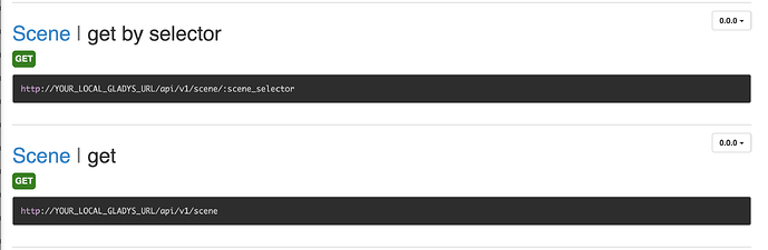

The API is simple:
What you’re interested in:

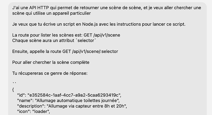

I’m sure if you copy-paste this message into ChatGPT, you’ll have a working script :joy:
Example:
ChatGPT’s response (I skimmed it; authentication is missing but otherwise it’s good):
