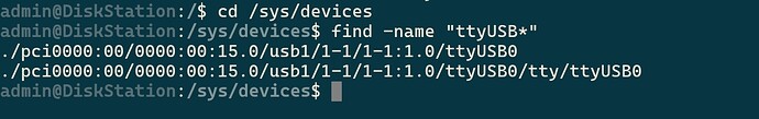

Gladys is on my Synology, the driver handling is still ok, but I don’t know what to select:
Here is the list shown via the terminal:

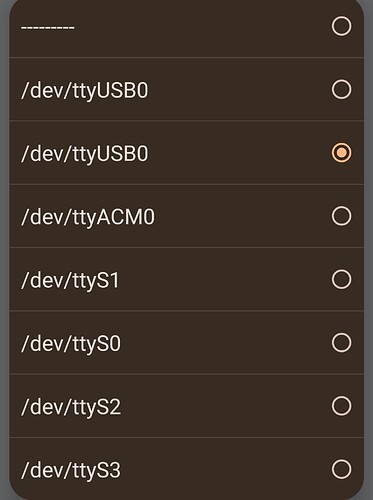

And here is what Gladys offers me:
Which one should I select? I’m confused ^^’ (I can’t select the first usb0 — it always selects the second)
Also, no matter what I select, I get the error SRSP - SYS - ping after 6000ms
I checked by plugging in my Sonoff dongle and it’s the usb0
I think that on the Gladys side I should select the first one but I can’t manage to do it..
