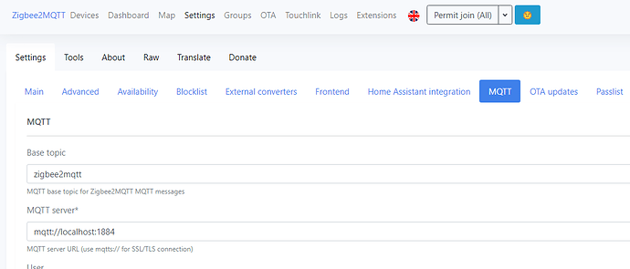

You wouldn’t have changed the port on the zigbee2mqtt side by any chance?
