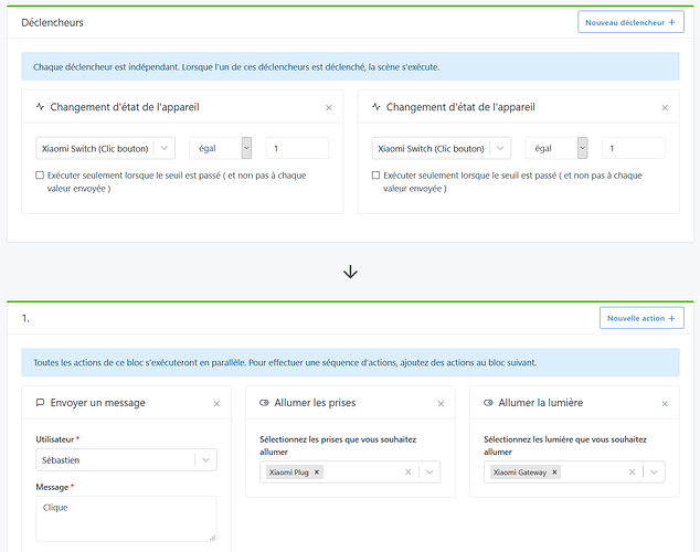

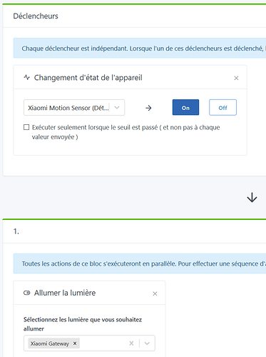

Here are the scene captures:
This is a test, I receive the message but neither the trigger works nor does the gateway light up:
The command actions on the devices are not yet developed. :wink:
OK, everything makes sense now!
That was quite surprising behavior.
Thanks again for your time.
