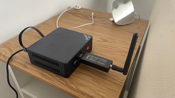

Quick feedback after 15 days on 2.6.1 with no reporting issues.
I’ve had a few reboots these past few days but I couldn’t determine whether it was hardware or software.
