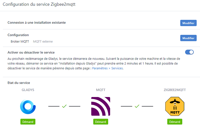

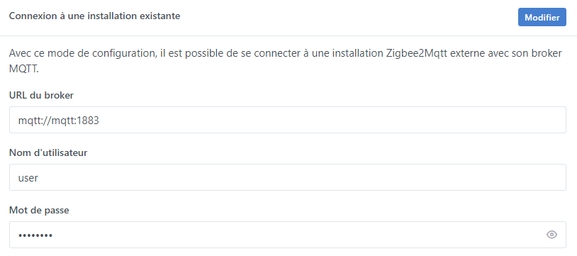

A very handy feature was introduced as a result (thanks to @pierre-gilles and the developers): the ability to use an external MQTT module, which is what I do:
That’s it for Gladys.
Aside from that, I have an MQTT container declared under Gladys (mqtt://mqtt:1833), and as many Z2M containers as LidlBoxes deployed and connected to my local network. The configuration is adapted for each one regarding the LidlBox address on the network. Don’t forget to change the Web UI port, default 8080.
