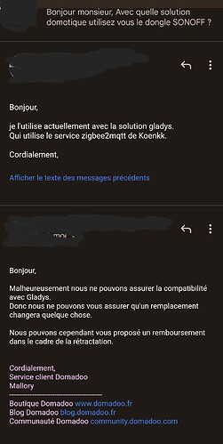

Oh I did it quickly but in my email I had put this:
Ps: Do we have a list of functional dongles somewhere? :wink:
You will need to add them to the Airtable list if it hasn’t been done already.
