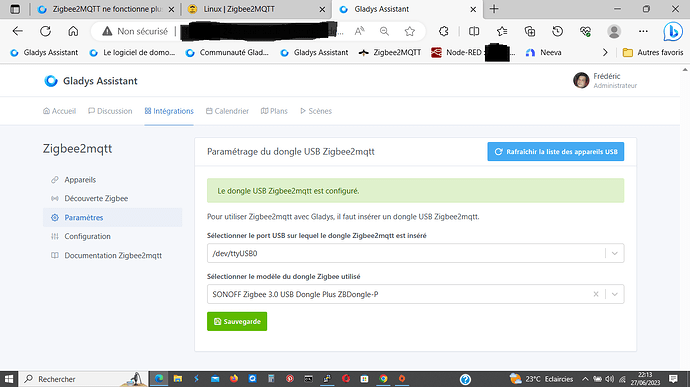

unbutu@unbutu:~$ ls -l /dev/serial/by-id
total 0
lrwxrwxrwx 1 root root 13 juin  27 18:17 usb-1a86_USB2.0-Serial-if00-port0 -> ../../ttyUSB0
lrwxrwxrwx 1 root root 13 juin  27 18:17 usb-ITead_Sonoff_Zigbee_3.0_USB_Dongle_Plus_0cac220e7329ec11a0de6d7840c9ce8d-if00-port0 -> ../../ttyUSB1
And in my zigbee2mqtt configuration I have this.
I still don’t understand how my dongle can change USB port without me changing the port on my mini PC.
I changed the configuration of my dongle in Gladys, I changed the USB port of my RFLink in Node-RED since both had the same one.
I restarted everything and nothing. I still have the same error in the zigbee2mqtt logs
In your last message, when you list your ports, your ZigBee dongle is on ttyUSB1 but configured for ttyUSB0 in Gladys…
Wouldn’t that change after a reboot or powering off the box?
Maybe, at startup, one dongle reacts faster than the other and gets assigned the slot?

I managed to solve my problem in another way.

I unplugged what was connected to the USB ports of my mini PC, leaving my Zigbee2MQTT dongle plugged in. I restarted Gladys. That forced my dongle to switch back to USB0; I checked that Zigbee2MQTT also saw it on USB0 and I restarted Gladys and Zigbee2MQTT. I started the Zigbee2MQTT logs and it had restarted.
