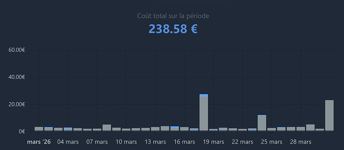

For example, this graph, which details the global is based on Lixee:
If I detail, in dark gray the subscription cost, in light gray the HP cost and in blue the HC cost, except that this does not reflect reality, even though my slots are configured correctly:

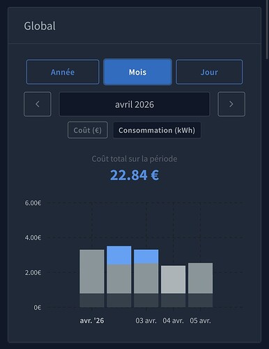

If we look at the April consumption (monthly view), that of April 4 is completely gray (so 100% HP) whereas if in the same graph I switch to daily view and display April 4:

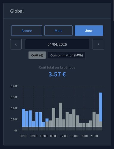

We can see a good proportion of off-peak consumption.

Regarding the graph, I also noticed the same thing. After checking, since the displayed totals are correct, one possibility is an issue with the histogram display? The HC/HP colors do not stack but mask each other.

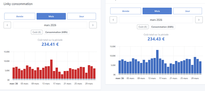

@pierre-gilles I have both, Enedis and Lixee. And it’s by comparing the two graphs to get the HC/HP details that I just noticed this.
On the left Lixee, on the right Linky.
Normally on the left on the Lixee I have 2 colors of graph HC blue HP red. Here, the red hides the blue.
Actually, I can also reproduce the issue. In the monthly view, everything is added up and only one color is displayed.

@pierre-gilles I don’t know if this is important, but I think the values are not added, but rather superimposed. You can see in my previous graph that the height of the columns for a day are not identical between the two graphs.
It’s the same thing :slight_smile:
Yes exactly, these are the HP/HC data from the Lixee TIC…
Hey, these are two views (monthly and daily) of the same graph

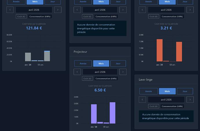

I’m reviving the topic with a question. I don’t know how the cost is calculated in relation to energy consumption, but in a graph I have 4 electrical devices, in the “consumption” display I have all 4, but in the “cost” display I only have 3… (they are identical pilot wire modules)

At first glance, I’d say the rate isn’t applied to your yellow module, but as to why… :frowning:
Things to check:
  • does it have a 30-minute cost in its history?
  • if you display a graph with 30-minute consumption and energy, do you see the same thing (normally yes)
  • if it has a 30-minute cost and you display it on a graph, do you see anything?
  • try recalculating all costs and see how it displays afterward.

It’s ok, I found the cause… I traced the device chain in question from Zigbee2Mqtt to the various Gladys steps, and I found that it was the only device not linked to the Enedis meter at the Energy Management integration level…
