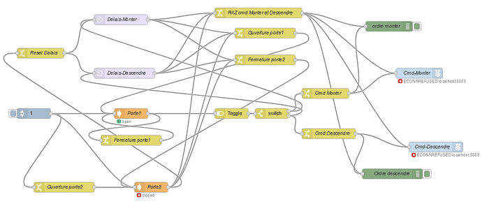

Une autre possibilité est d’utiliser uniquement un bouton à impulsion (toujours le même message) qui permet de monter, de stopper ou de descendre le volet. Derrière bien sûr il faut gérer la commande par un programme.
Voici un exemple sous node-red (non testé en réel et sûrement à simplifier et améliorer) :
[{"id":"f7c7dff4.84a878","type":"tab","label":"Flow 1","disabled":false,"info":""},{"id":"d9c64d70.401e88","type":"toggle","z":"f7c7dff4.84a878","name":"","onOffTopic":"","onValue":"Monter","onType":"str","offValue":"Descendre","offType":"str","toggleTopic":"","toggleValue":"","toggleType":"any","passOnOff":"ifChanged","x":710,"y":620,"wires":[["78be339b.b82cd4"]]},{"id":"7e57fa0e.b124ac","type":"gate","z":"f7c7dff4.84a878","name":"Porte1","controlTopic":"control","defaultState":"open","openCmd":"open","closeCmd":"close","toggleCmd":"toggle","defaultCmd":"default","statusCmd":"status","persist":false,"x":410,"y":620,"wires":[["d9c64d70.401e88","59dd700a.af8a48"]]},{"id":"9e19b878.d70778","type":"inject","z":"f7c7dff4.84a878","name":"","props":[{"p":"payload"}],"repeat":"","crontab":"","once":false,"onceDelay":0.1,"topic":"","payload":"1","payloadType":"num","x":120,"y":620,"wires":[["7e57fa0e.b124ac","d88405a7.90e3d","150843d.3e3c5bc"]]},{"id":"59dd700a.af8a48","type":"change","z":"f7c7dff4.84a878","name":"Fermeture porte1","rules":[{"t":"set","p":"payload","pt":"msg","to":"close","tot":"str"},{"t":"set","p":"topic","pt":"msg","to":"control","tot":"str"}],"action":"","property":"","from":"","to":"","reg":false,"x":410,"y":700,"wires":[["7e57fa0e.b124ac"]]},{"id":"eb39983c.de23b","type":"delay","z":"f7c7dff4.84a878","name":"Delais-Monter","pauseType":"delay","timeout":"5","timeoutUnits":"seconds","rate":"1","nbRateUnits":"1","rateUnits":"second","randomFirst":"1","randomLast":"5","randomUnits":"seconds","drop":false,"x":380,"y":340,"wires":[["28a95477.a4e2e4","4c732a2e.09a63c","6279ad34.e5249c"]]},{"id":"28a95477.a4e2e4","type":"change","z":"f7c7dff4.84a878","name":"Ouverture porte1 ","rules":[{"t":"set","p":"payload","pt":"msg","to":"open","tot":"str"},{"t":"set","p":"topic","pt":"msg","to":"control","tot":"str"}],"action":"","property":"","from":"","to":"","reg":false,"x":810,"y":380,"wires":[["7e57fa0e.b124ac"]]},{"id":"78be339b.b82cd4","type":"switch","z":"f7c7dff4.84a878","name":"","property":"payload","propertyType":"msg","rules":[{"t":"eq","v":"Monter","vt":"str"},{"t":"eq","v":"Descendre","vt":"str"}],"checkall":"true","repair":false,"outputs":2,"x":830,"y":620,"wires":[["eb39983c.de23b","56c08aac.df5f54"],["9d214b72.543dd8","d7d4fc60.b18198"]]},{"id":"9d214b72.543dd8","type":"delay","z":"f7c7dff4.84a878","name":"Delais-Descendre","pauseType":"delay","timeout":"5","timeoutUnits":"seconds","rate":"1","nbRateUnits":"1","rateUnits":"second","randomFirst":"1","randomLast":"5","randomUnits":"seconds","drop":false,"x":390,"y":500,"wires":[["28a95477.a4e2e4","4c732a2e.09a63c","6279ad34.e5249c"]]},{"id":"3da4444c.f68c74","type":"pi-gpiod out","z":"f7c7dff4.84a878","name":"Cmd-Descendre","host":"localhost","port":8888,"pin":"17","set":true,"level":"0","out":"out","sermin":"1000","sermax":"2000","freq":"800","x":1320,"y":720,"wires":[]},{"id":"96fd20cc.c28ee8","type":"pi-gpiod out","z":"f7c7dff4.84a878","name":"Cmd-Monter","host":"localhost","port":8888,"pin":"18","set":true,"level":"0","out":"out","sermin":"1000","sermax":"2000","freq":"800","x":1270,"y":500,"wires":[]},{"id":"4c732a2e.09a63c","type":"change","z":"f7c7dff4.84a878","name":"RAZ cmd Monter et Descendre","rules":[{"t":"set","p":"payload","pt":"msg","to":"0","tot":"num"}],"action":"","property":"","from":"","to":"","reg":false,"x":790,"y":320,"wires":[["96fd20cc.c28ee8","3da4444c.f68c74","7d3de0e.ac55ea","957cfc2a.95f948"]]},{"id":"d7d4fc60.b18198","type":"change","z":"f7c7dff4.84a878","name":"Cmd Descendre","rules":[{"t":"set","p":"payload","pt":"msg","to":"1","tot":"num"}],"action":"","property":"","from":"","to":"","reg":false,"x":1000,"y":680,"wires":[["3da4444c.f68c74","957cfc2a.95f948"]]},{"id":"56c08aac.df5f54","type":"change","z":"f7c7dff4.84a878","name":"Cmd Monter","rules":[{"t":"set","p":"payload","pt":"msg","to":"1","tot":"num"}],"action":"","property":"","from":"","to":"","reg":false,"x":990,"y":560,"wires":[["96fd20cc.c28ee8","7d3de0e.ac55ea"]]},{"id":"150843d.3e3c5bc","type":"gate","z":"f7c7dff4.84a878","name":"Porte2","controlTopic":"control","defaultState":"closed","openCmd":"open","closeCmd":"close","toggleCmd":"toggle","defaultCmd":"default","statusCmd":"status","persist":false,"x":470,"y":840,"wires":[["4c732a2e.09a63c","28a95477.a4e2e4","6279ad34.e5249c","dc5b447a.5abbb8"]]},{"id":"d88405a7.90e3d","type":"change","z":"f7c7dff4.84a878","name":"Ouverture porte2","rules":[{"t":"set","p":"payload","pt":"msg","to":"open","tot":"str"},{"t":"set","p":"topic","pt":"msg","to":"control","tot":"str"}],"action":"","property":"","from":"","to":"","reg":false,"x":210,"y":840,"wires":[["150843d.3e3c5bc"]]},{"id":"6279ad34.e5249c","type":"change","z":"f7c7dff4.84a878","name":"Fermeture porte2","rules":[{"t":"set","p":"payload","pt":"msg","to":"close","tot":"str"},{"t":"set","p":"topic","pt":"msg","to":"control","tot":"str"}],"action":"","property":"","from":"","to":"","reg":false,"x":810,"y":460,"wires":[["150843d.3e3c5bc"]]},{"id":"7d3de0e.ac55ea","type":"debug","z":"f7c7dff4.84a878","name":"ordre monter","active":true,"tosidebar":true,"console":false,"tostatus":false,"complete":"payload","targetType":"msg","statusVal":"","statusType":"auto","x":1180,"y":360,"wires":[]},{"id":"957cfc2a.95f948","type":"debug","z":"f7c7dff4.84a878","name":"Ordre descendre","active":true,"tosidebar":true,"console":false,"tostatus":false,"complete":"payload","targetType":"msg","statusVal":"","statusType":"auto","x":1190,"y":800,"wires":[]},{"id":"dc5b447a.5abbb8","type":"change","z":"f7c7dff4.84a878","name":"Reset Delais","rules":[{"t":"set","p":"reset","pt":"msg","to":"","tot":"str"}],"action":"","property":"","from":"","to":"","reg":false,"x":140,"y":440,"wires":[["eb39983c.de23b","9d214b72.543dd8"]]}]
Ce qui est cool avec un bouton à impulsion c’est qu’on peut commander ce qu’on veut (un moteur, une fonction télérupteur, une RAZ, le programmer en appui court ou long, double clic…).
