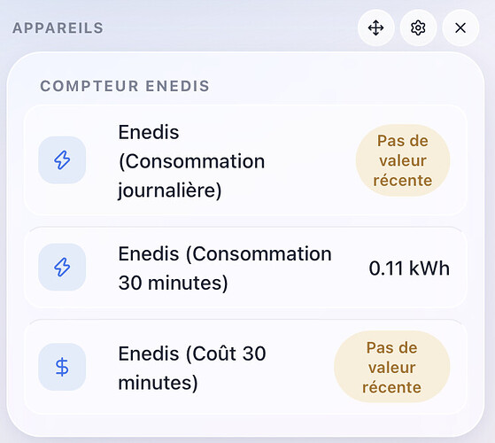

Hello

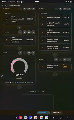

Gladys is retrieving data but it seems incorrect!
You should compare what Gladys retrieves with what the Enedis website gives you.
In your screenshot, are you comparing with Ecojoko?
Thanks,
I had forgotten one thing, Enedis only reports the previous day’s consumption.
So it’s all good :+1:

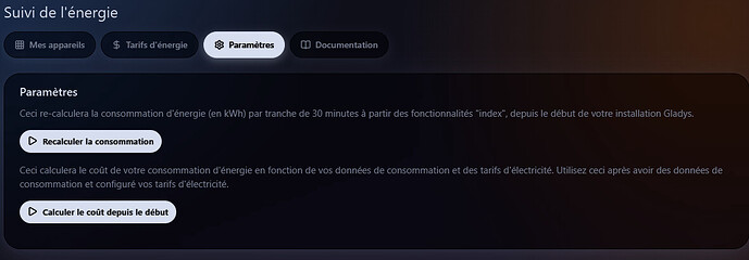

Hello, for my part I don’t have any feedback except for the 30’ consumption but which seems to be a fixed value since it was set up. Any ideas? I specify that I’m brand new to Gladys, this might explain it :-). Thanks in advance.
I don’t know if this will solve your problem, but when you install the widget for the first time, you need to recalculate from the beginning:
Thank you, this helped me realize that I wasn’t using the right widget. I have my data now, I just need to figure out how to use it.
