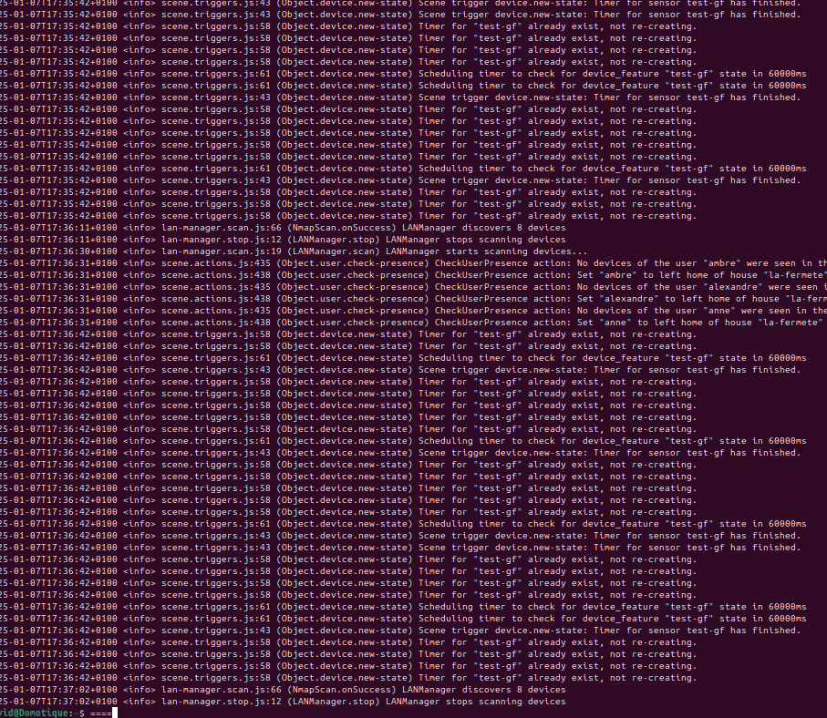

here I have this in my log, something very repetitive that keeps coming back very often and I don’t know what it is?
thanks
025-01-03T11:47:06+0100 \u003cinfo\u003e scene.triggers.js:58 (Object.device.new-state) Timer for \"test-gf\" already exist, not re-creating.
2025-01-03T11:47:06+0100 \u003cinfo\u003e scene.triggers.js:58 (Object.device.new-state) Timer for \"test-gf\" already exist, not re-creating.
2025-01-03T11:47:06+0100 \u003cinfo\u003e scene.triggers.js:61 (Object.device.new-state) Scheduling timer to check for device_feature \"test-gf\" state in 60000ms
2025-01-03T11:47:06+0100 \u003cinfo\u003e scene.triggers.js:43 (Object.device.new-state) Scene trigger device.new-state: Timer for sensor test-gf has finished.

so I made it simpler: I directly entered the URL with test-gf and nothing
and it comes back really often, plus all that in less than two minutes
« Timer for sensor test-gf »
It’s a sensor that triggers this scene.
ok so I have a sensor called test gf somewhere and it’s called many times, is that it?
Hi @Prof_Techno, nothing to worry about, it’s just the new feature that allows testing whether a condition is validated for a certain amount of time (I’m talking about this: Gladys Assistant 4.49 : Déclencheurs avec délai dans les scènes! )
What you see is just the logs of the scenes that use this feature. Everything is normal :slight_smile:
OK, but then why test time?
I think it’s indeed a sensor called that, either by default or because you renamed it at some point.
