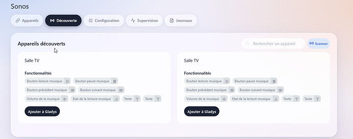

After having to open port 1400 in TCP, I now have my 2 Sonos speakers:
I haven’t been able to test it yet because the kids are sleeping :innocent:
They have the same name here, but I checked in the Sonos app and it’s the same. I’ll have to look into why later :sweat_smile:

On my end, discovery doesn’t work with a simple scan, but it does work by specifying the IPs of the speakers, even from another VLAN. However, it gives me the text function twice? and doesn’t provide as many settings as the HA integration (bass loudness, etc).

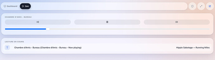

The now playing feature also works, but it displays the speaker name twice. And otherwise, I have the correct name for all the speakers. However, I don’t understand what the play URI function is for.
No worries, he has two text functions, it’s normal: play uri and current song
And what you see in duplicate is the operation of the gladys device (function)
