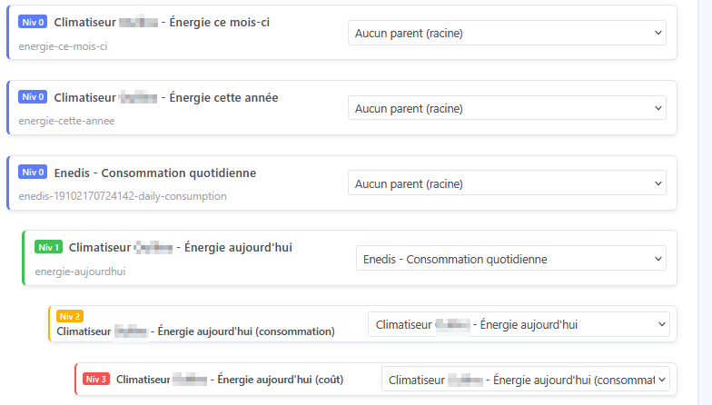

I wanted to get your opinion on a feature I started developing with claude, but it involves a counterpart in energy tracking.
Basically, I noticed that in the energy tracking section, this appeared:
This was also at level 0 initially, but you’ll understand better a bit later :upside_down_face:
I thought we could leverage Gladys’ energy tracking with this information that comes back to Gladys:
So I asked him to create two features for me: « 30-minute Consumption Â» and « 30-minute Cost Â».
After testing it on August 8th, the consumption value exactly matches what I have in the Daikin app (same for September 9th):

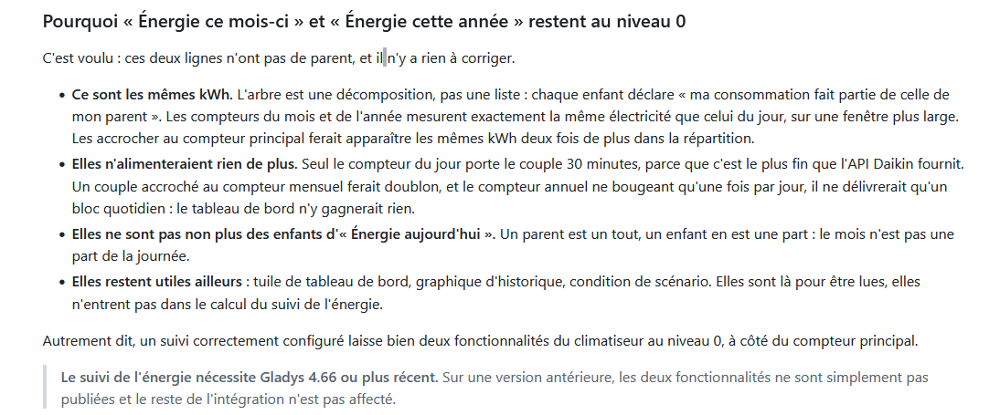

The catch is that in energy tracking, « Energy this month Â» and « Energy this year Â» remain at level 0 from the integration, as indicated in the doc here:
Basically, it looks like this:
For you, can I push this version to production with the 30-minute consumption and cost, or are there things to review?
Thanks :wink:

  • The energy level of your capabilities scale serves no purpose: energy_parent_id arrived in Gladys in August 2025, well before external integrations. Any instance capable of running your container already has energy tracking.
  • « Energy this month Â» and « Energy this year Â» must stay at level 0, it’s normal and you should not link them at all: they are also typed energy, so they appear as possible parents in Settings → Energy Tracking, and a user who wires them would count the same kWh multiple times. A line in the documentation saying « only link the day’s consumption Â» will avoid the question.

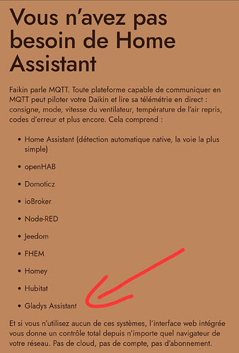

I just discovered this fake site:
It promises 100% local Daikin control
Even funnier, it lists Gladys as compatible (which makes sense since they use MQTT)
@pierre-gilles :flexed_biceps:
