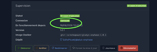

I’m currently testing the Enphase integration
I’ve already installed the integration after some small connection issues with the gateway, even though my IP address was correct, but after a manual restart it’s okay.
Retrieving the local access token was a breeze

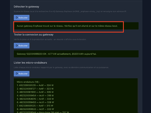

If I test the gateway detection, the response says it can’t find the gateway, even though Gladys is well connected to the gateway
log file

[2026-08-16T12:31:45.700Z] [INFO] [enphase-system] Action test_gateway -> live request to the gateway
[2026-08-16T12:32:54.317Z] [INFO] [enphase-system] Action test_gateway -> live request to the gateway
[2026-08-16T12:33:08.870Z] [INFO] Action detect_gateway -> scanning the network
[2026-08-16T12:33:18.886Z] [WARN] Discovered candidate at fdc0:181:9772:435a:21d:c0ff:fe86:18bd did not validate (ERR_INVALID_URL), ignoring it

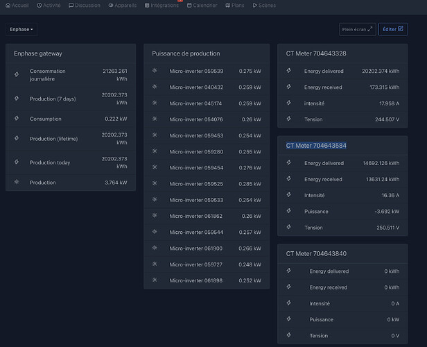

I do retrieve the devices in Gladys
14 micro inverters
production consumption values I’m not sure cumulative to check.
I now need to verify the accuracy of the values reported in Gladys and compare them with the Enphase app and the values I retrieve via Home Assistant.
I’ll keep you updated as soon as I finish the checks.

Thanks for your feedback and error log. I’ll look into it as soon as I have time.
For the values, I checked with the values that HA gives me, so it should be correct.
I just pushed version 1.0.2 which fixes the discovery issue and the timeout error.
