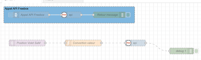

So I’m going to explore Node-RED a bit more to interact with my shutters and maybe more in the future.

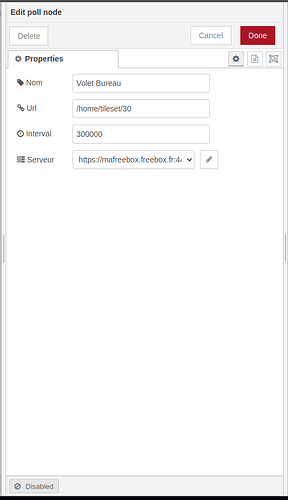

A question about Node-RED: did you leave Node-RED enabled with what I gave you for the shutters at the same time as the Freebox integration?
Maybe it’s after a certain number of requests that the API crashes (or is intentionally blocked by Free).
If that’s the case, could you retry after removing the Node-RED part?
You can just disable the node for your shutter that makes requests to the Freebox by clicking on enable in the properties at the bottom left and it will switch to disabled, so it will no longer make requests.
Then the node becomes transparent with dashed lines
Hello @_Will_71,
I’ve disabled the affected stream and restarted the box to follow up.
Ok keep me posted. Thanks
Well, the shutters have indeed just closed.
We’ll see tomorrow morning at opening and in the following days
Hi @_Will_71 ,
Well, the shutters seem to be working properly since the last time (well, the shutters that close around 5:30 PM — that’s early, ah this time change!), FYI I also set the « Refresh Frequency » back to 30 s which I had changed to 10 s, hence maybe too many requests + repeated tests!! To be continued.
