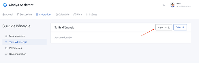

In the integration, there is now an « Import » button:
This button asks you to select the relevant electric meter, then presents the available energy contracts.
This list comes from the crowdsourced JSON in the repo above.
The idea behind this JSON is that anyone can submit a PR to propose a new contract if their contract isn’t in the list.
I think that’s the power of open source: making everything editable by the community!

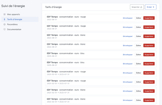

Then, when you click « Import rates », it creates all the current and historical prices corresponding to that contract:
In the case of EDF Tempo, for example, there are 30 rates per power level, so it’s much more convenient to be able to import them automatically :smiley:

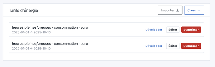

I created 2 rates with the schedules you gave me :

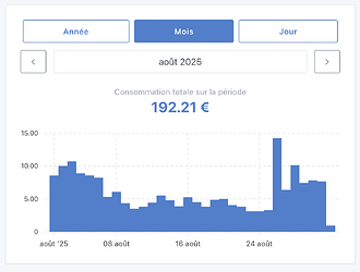

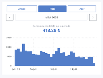

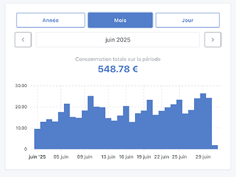

I’m running the algorithm from the start, and I get this :
![Screenshot 2025-10-10 at 17.12.57|665x500, 50%](upload://4shmwsOKpW53xb4aPkuwW6qj13
That seems pretty good to me. I started installing my new panels on July 10, continued on July 25 and finished in early August with the addition of a battery.
We went on vacation in August but there are people who look after the house during the summer while we’re away + the campsite that’s running + the pool.
My consumption isn’t lower in summer than in winter, but with the addition of the 10 kW of panels, it seems very good to me — it’s about what I had on Home Assistant (HA).
Well done.

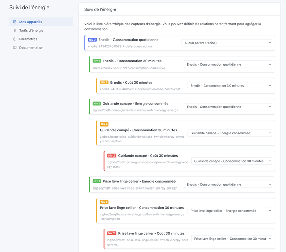

  • Zigbee2mqtt : The integration now automatically creates the entities/features for 30-minute consumption and 30-minute cost, and automatically links each device to the meter configured in the integration « Energy monitoring » (« Suivi de l’énergie »).
  • Consumption calculation from indexes : Now fully functional — every 30 minutes, Gladys calculates the consumption over the last 30 minutes for all « index » features and stores it. This consumption in kWh is then used to calculate consumption in euros.

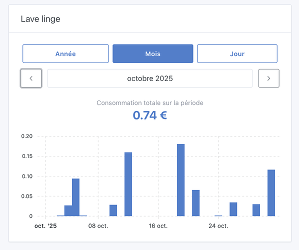

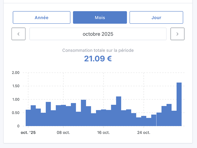

On my system, it looks like this:
On the dashboard:
What’s super convenient is that I can display graphs per device:
A chance to see that a washing machine uses almost nothing :smiley:
