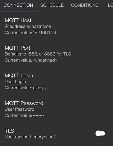

When I click on « Check Connection » I always get an error « Connection Failed ».
Which port did you configure? TLS or not?
Thanks for your help :slight_smile:
Hello
No TLS
Thanks for your reply :slight_smile:
I don’t understand, but it’s impossible to connect with the « test connection ». Every time I get a « Timeout » error.
Yet I even checked the firewall on my Raspberry Pi, port 1883 is open, the Gladys password is correct, I have no more ideas for debugging..

Via my Wireguard VPN which is on the Raspberry Pi, I can connect the application to MQTT. So it is indeed an incoming traffic issue.
Thanks for your confirmation of the application config :slight_smile:

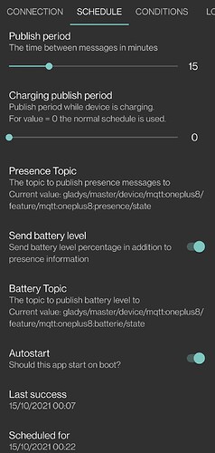

I put this in the Android application, it sends successfully, but Gladys doesn’t seem to understand the data (I don’t see anything in Gladys, or in the logs):
  • Presence Topic: oneplus7tpro/presence
  • Battery Topic: oneplus7tpro/battery

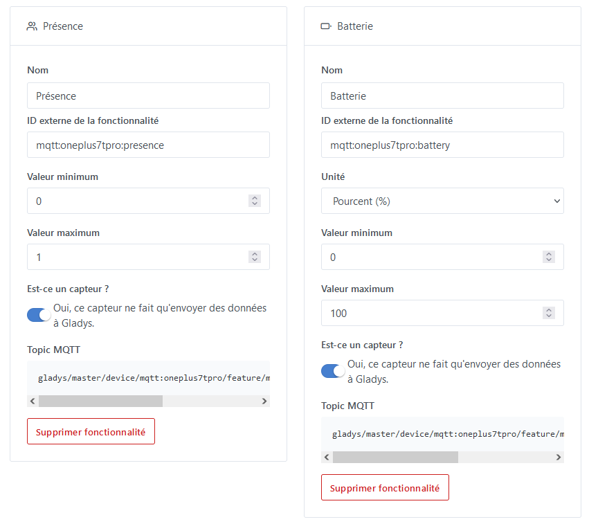

Actually, it’s indicated in Gladys, to know:
gladys/master/device/mqtt:oneplus7tpro/feature/mqtt:oneplus7tpro:presence/state

Did you set up the application 1 when you connect to the network?

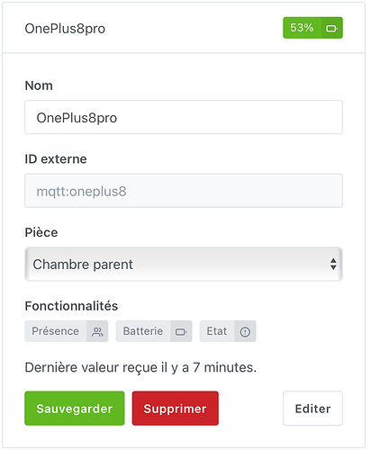

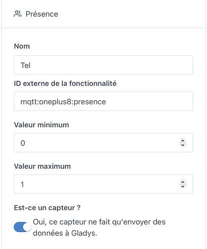

Here is my device:
For information, I also send the status of my battery, it might be useful :slight_smile:
And on the application side
I have two because I have multiple networks at home :slight_smile:

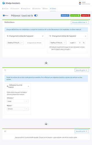

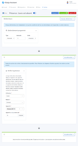

Can you share screenshots of your scenes so we can see where it’s not working?
Here are the two scenes I use to manage my presence.
1 - Presence
2 - Absence
Investigations
In scene #1, if I only rely on « Device state change, » Gladys never marks me as present, even though the « presence » device display in the dashboard is correct (for example, a few seconds ago). By adding the « battery » device linked to my phone and sent at the same time as my presence, I can uncheck the option « Run only when the threshold is crossed, » which allows me to be marked as present with each message received.

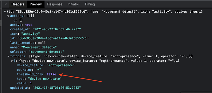

Super weird! The « presence detection » triggers have the option « execute only when the threshold is passed » hidden and set to « false » by default. You can check in the API calls, the GET /api/scene/:scene_selector route should show you something like this:
I just did the test at my place, and I can’t reproduce your problem: the scene is executed every time for me…

Can you check the JSON of your scene via the API as shown in my previous post? :slight_smile:

« threshold_only »: false
It looks good to me!
Do you have specific logs on the Gladys side that could explain why it’s not working? Are you 1000% sure that an integer value 1 is sent via the MQTT integration every time you enter?
Because I really can’t reproduce it, at my place if I send 1 several times in a row, the scene executes each time

  • In Gladys, under « MQTT », I create a new device of type « presence » with values « 1 » and « 0 » (no choice but to use numbers).

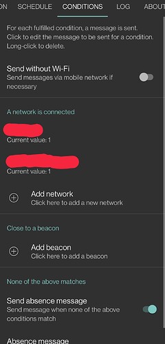

Tip: I wanted the application to send messages without giving it access to the GPS and keep my GPS always on (necessary to allow it to know the Wi-Fi SSID).
I use what the application calls « Absence messages » to notify Gladys that I am home on Wi-Fi (logical :sweat_smile:). Knowing that Gladys marks me as present when it has messages and absent when it has nothing, it works as I want!
For this:
  1. Deny GPS permission (location)
  2. In « conditions », enable « Send without Wi-Fi »
  3. In the « None of the above matches » section, enable « Send absence message » and modify the « Absence message » value to « 1 ».
