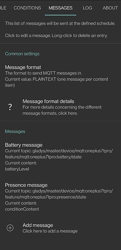

I’m reactivating the topic because I can’t find how to add topics in the application.
Would you have the opportunity to explain or create a tutorial for me?
I will try to set it up for my partner and me on both phones.
Thanks.
You need to go to the « Message » tab and there you will be able to modify the messages related to presence and battery or whatever you have declared in Gladys.

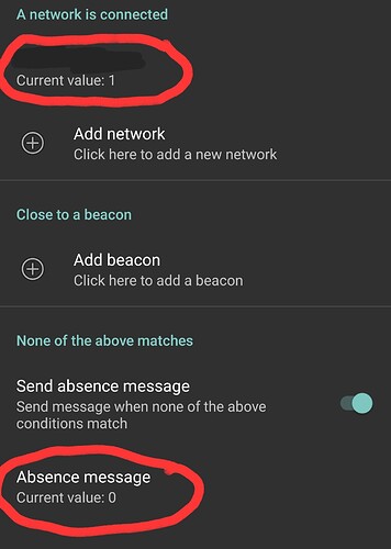

For me, it’s the presence message that I can’t change to « 1 ».
On my screen you need to click on the Wi-Fi to set it to a value other than « online » in the condition tab..
Good catch! I hadn’t set up the Wi-Fi and couldn’t see the menu anymore.
