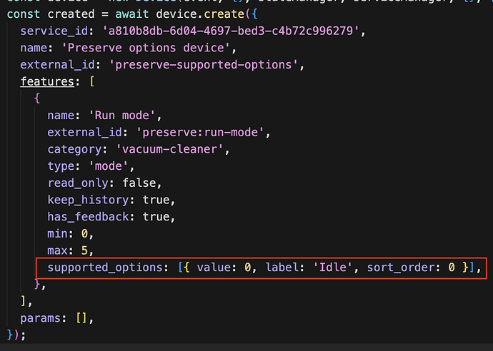

The PR:
It looks good to me.
  • Do all values always need to be mapped somewhere in Gladys (as they are today)?
  • How will this work for existing devices?
  • And how are the supported_options of a feature filled in?
Yes! Nothing changes about that.
We will be able to add a device update, just like we do when a feature evolves :slight_smile:
The integration fills it if it’s available/possible!

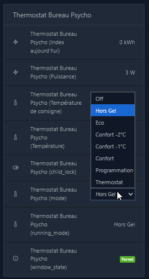

It works perfectly! Hoping that „we‟ have implemented it correctly, I had to take it over again; it was buried in something ultra-complex with repetition.
Device with 4 modes:
Device with all modes:
