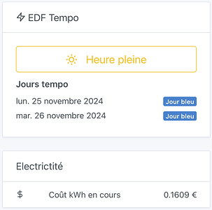

Here is the result on my dashboard :

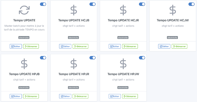

Here are the sequences ![]()
1. MQTT device creation

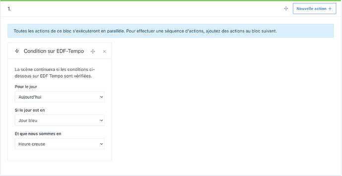

2. Scene to declare a rate (x6)
You can retrieve the rates here (rates as of 1/11/2024).

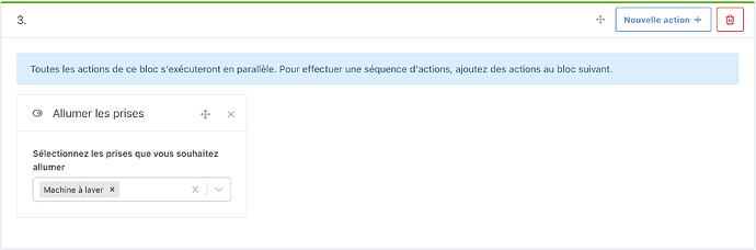

You can then duplicate this scene to create the others. Make sure not to forget to change the rate and to turn off the plugs instead of turning them on when you are in Red Peak Hours ![]()

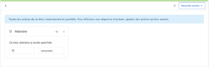

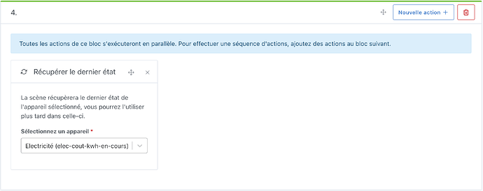

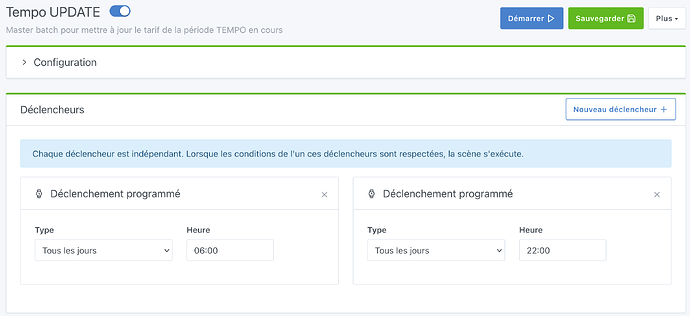

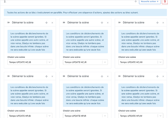

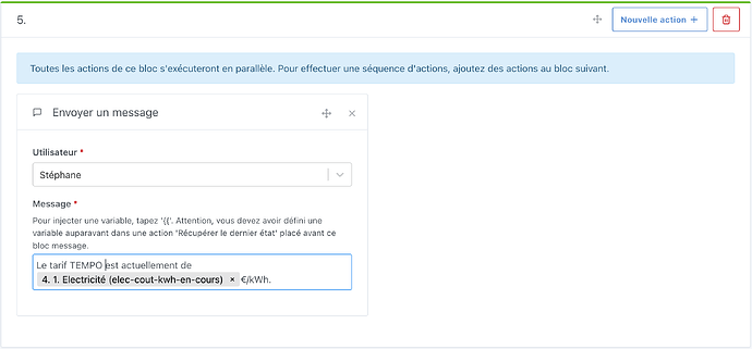

3. Main scene creation
I wait 15s to ensure that the day and hour values are properly updated in the TEMPO integration, then 30s to make sure all scenes are finished (since I trigger them all at the same time and I have lags on my Gladys setup, I prefer to be cautious).
