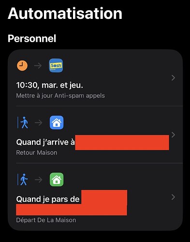

For my part, for presence management, I set up 2 shortcuts on my phone:
My phone itself does the zone entry/exit detection, and then it makes a request to Gladys (via the Gladys Plus Open API: Open API | Gladys Assistant )
It works great and I think it’s the most battery-optimized way to do it, because the phone handles all the intelligence and so it’s optimized by Apple :slight_smile:
