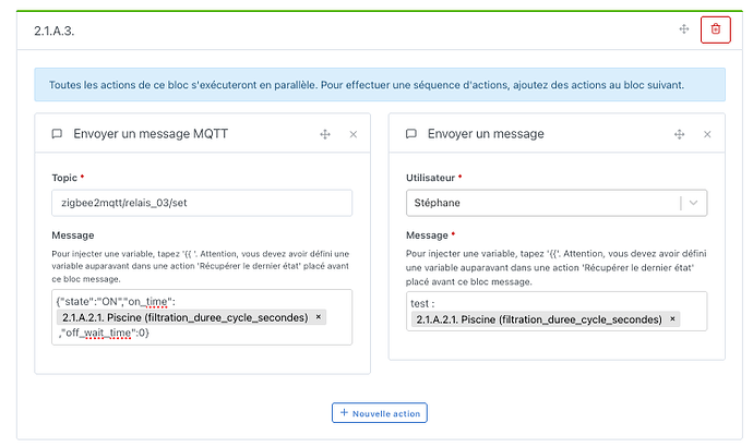

And as I send myself a message at the end of the Wait, I will have to create a monitoring scene that checks every minute if the module is on or off.

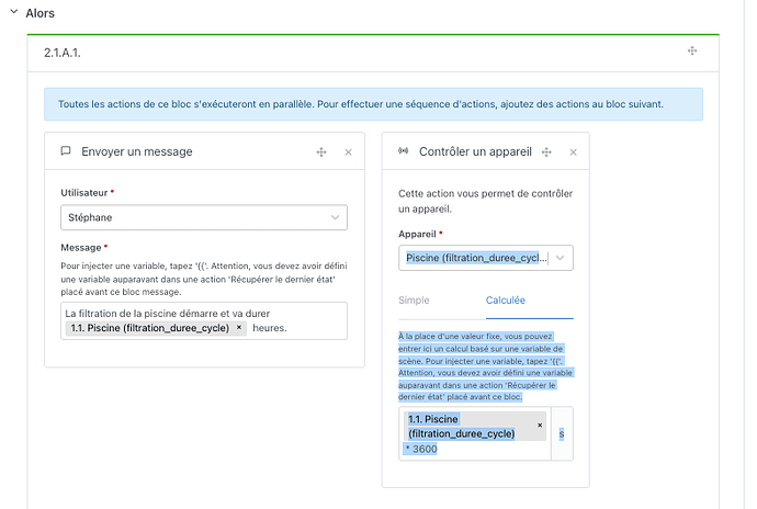

I tried with the variable calculation {"state":"ON","on_time": 1.1. Pool (filtration_cycle_duration) *3600 ,"off_wait_time":0} and apparently it didn’t work
After some tests, you should not take the action Send a zigbee2mqtt message but Send an MQTT message otherwise it doesn’t work. @pierre-gilles is there a specific difference between the 2 actions?
I tested {"state":"ON","on_time":60,"off_wait_time":10} in MQTT (not zigbee2mqtt) and it works, 1 minute later the pump stops properly.
I tested {"state":"ON","on_time":10800,"off_wait_time":10} and there is an issue, either on Gladys’ side or z2m, because everything is multiplied by 10 and therefore I have an out of range:
z2m: Publish 'set' 'state' to 'relais_03' failed: 'RangeError [ERR_OUT_OF_RANGE]: ZCL command 0x84b4dbfffe08ce6e/1 genOnOff.onWithTimedOff({"ctrlbits":0,"ontime":108000,"offwaittime":100}, {"timeout":10000,"disableResponse":false,"disableRecovery":false,"disableDefaultResponse":false,"direction":0,"reservedBits":0,"writeUndiv":false}) failed (The value of "value" is out of range. It must be >= 0 and <= 65535. Received 108000)'

To do your multiplication, you need to take it out of the payload: a Set a value action in formula mode on an MQTT number feature (pompe_on_time), with the formula {{...}}*3600, then a Retrieve the last state on this feature, and finally {{x.y.last_value}} in the JSON.

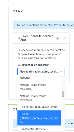

Create an MQTT number feature pompe_minutes_restantes.
Scene « Start the pump »:
Set a value: pompe_minutes_restantes = 180
Send an MQTT message to zigbee2mqtt/relais_03/set: {"state":"ON","on_time":900,"off_wait_time":0}
Scene « Pump monitoring », scheduled trigger in interval every 10 minutes:
Retrieve the last state of pompe_minutes_restantes

I do have an intermediate step to avoid the calculation:
And the message sent to me indicates the recalculated time in seconds, but it doesn’t work in the payload.
And I test with 1 hour to be sure not to have an out of range.

The captures don’t allow me to see the exact characters. Can you copy-paste, in text:
the exact content of the message field of your MQTT action;
the exact topic;
and if possible the output of mosquitto_sub -h <your_broker> -t 'zigbee2mqtt/relais_03/set' -v while you launch the scene.
With that, we’ll know in thirty seconds if it’s the }}}, an empty variable, or something else.

No worries @pierre-gilles, I know you have a lot on your plate right now and you need an assistant ! … Gladys? No, Claude
It’s good, I finally understood how it works and so before reconverting in Z2M, there is the fatal barrier of 65535 not to exceed. All good!
copy/paste as is:
2.1.A.2.1. Pool (filtration_duree_cycle_secondes)
,"off_wait_time":0}
but it’s not possible to give the exact content because we no longer have the curly braces once but I have a space after the variable:
I have no idea where to type this command because in the Gladys docker it tells me unknown command
no shortcut, I have the full topic with zigbee2mqtt/relais_03/set.
And I had tested both just in case
Everything is absolutely the same in terms of login/password configurations in MQTT and Z2M, and everything is operational otherwise I would have issues controlling all the other devices:
I don’t know if you have a Claude account, but it might be faster if you talked to them directly
Here’s Claude’s response:
Found. And it’s not you, it’s us — your copy-paste contained the answer, you just had to look at the characters one by one.
Your payload contains a space that isn’t one.
When you insert a variable from the list, the editor automatically adds a space after it — that’s the one you noticed. Except the browser doesn’t put a regular space: it puts a non-breaking space, the character U+00A0. Visually it’s identical, even in a copy-paste, but for a JSON parser it’s an invalid character in that position.
So your payload goes out like this, with a non-breaking space where I’ve put the symbol:
{"state":"ON","on_time":3600␣,"off_wait_time":0}
JSON.parse refuses, parseMessage returns undefined, and Z2M logs its famous Invalid message 'undefined'. The loop is complete.
I replicated your exact input in a browser, with your variable and payload: I reproduce the character identically. And that finally explains everything else:
your notification with the same variable displays correctly — a non-breaking space in a sentence doesn’t show and doesn’t bother anyone;
your test from post #5 with on_time:60 hardcoded worked — no variable, so no added space, so no non-breaking space;
and nothing could appear in the logs, neither for us nor for Z2M.
